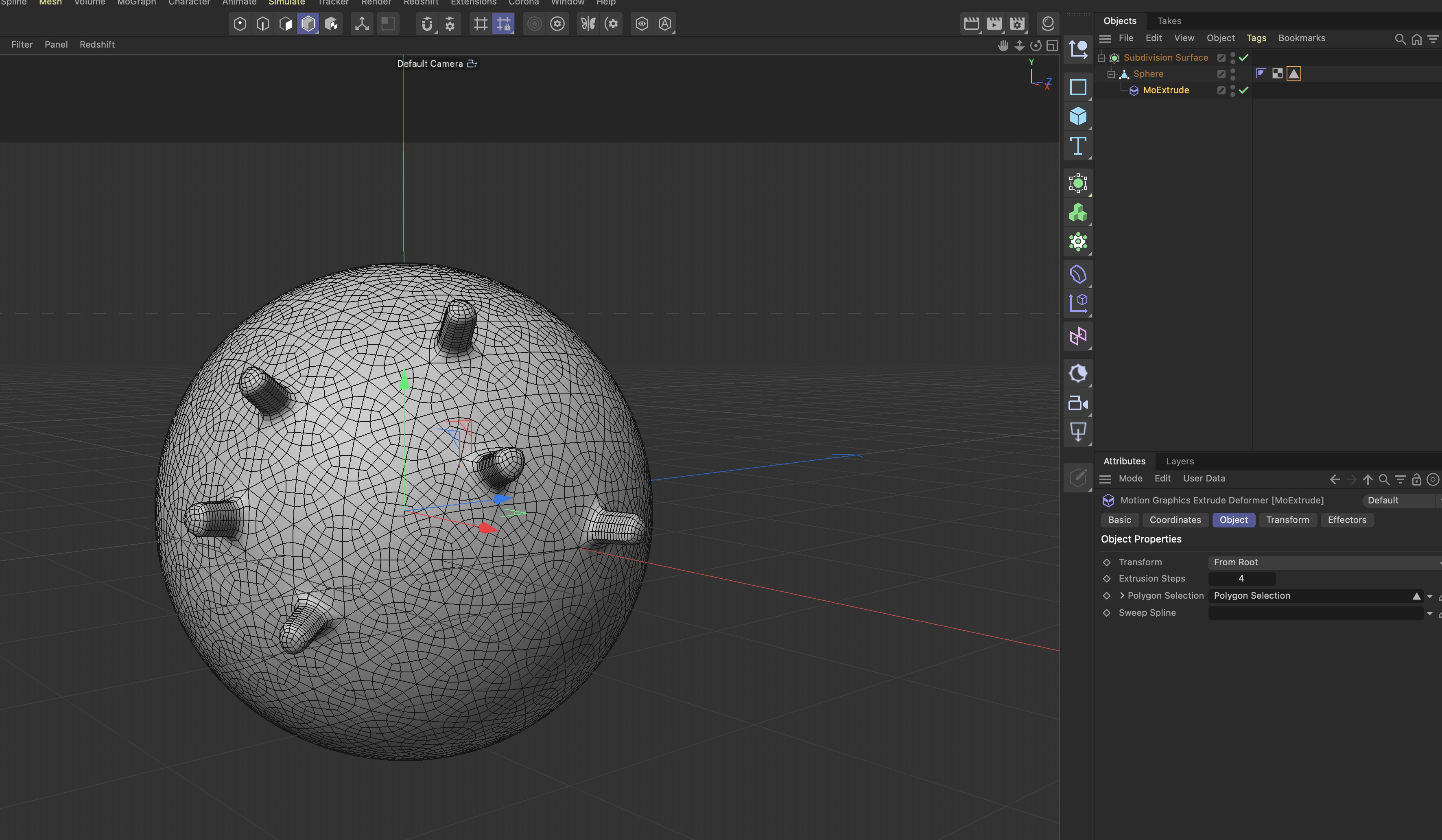

Very good reference here...so, I think you can achieve this results by using some polygons from a "sphere" object with a good poly topology and create a Mo extrude deformer you can find where the mograph cloner it is.
With it you can extrude some selections and use mograph effectors or fields to make some interesting effects. The rest of the object can be made by a displacer object placed into it or with special material with a noise into the displacement channel. :)

Thank you very much for your reply. I attempted to recreate the tentacles using the Mo extrude deformer and achieved some interesting results. However, the tentacles still appear quite similar. Combining the Mo extrude deformer with some noise in the displacement channel works better, though. I was just hoping there would be a single-step method to achieve this effect (I admit this sounds a bit lazy :-)
Messaggi: 10609
Re: Dendritic Cell: How to create small "Tentacles"
Hi Alohaey, I'm happy you achieve some good results...so...you can work with a single step by manually create an extrusion on the selected poly, but you need to do the same step on other polygons to make more tentacles...with MoExtrude you can make many copies on polygons selection and change value with some effectors...

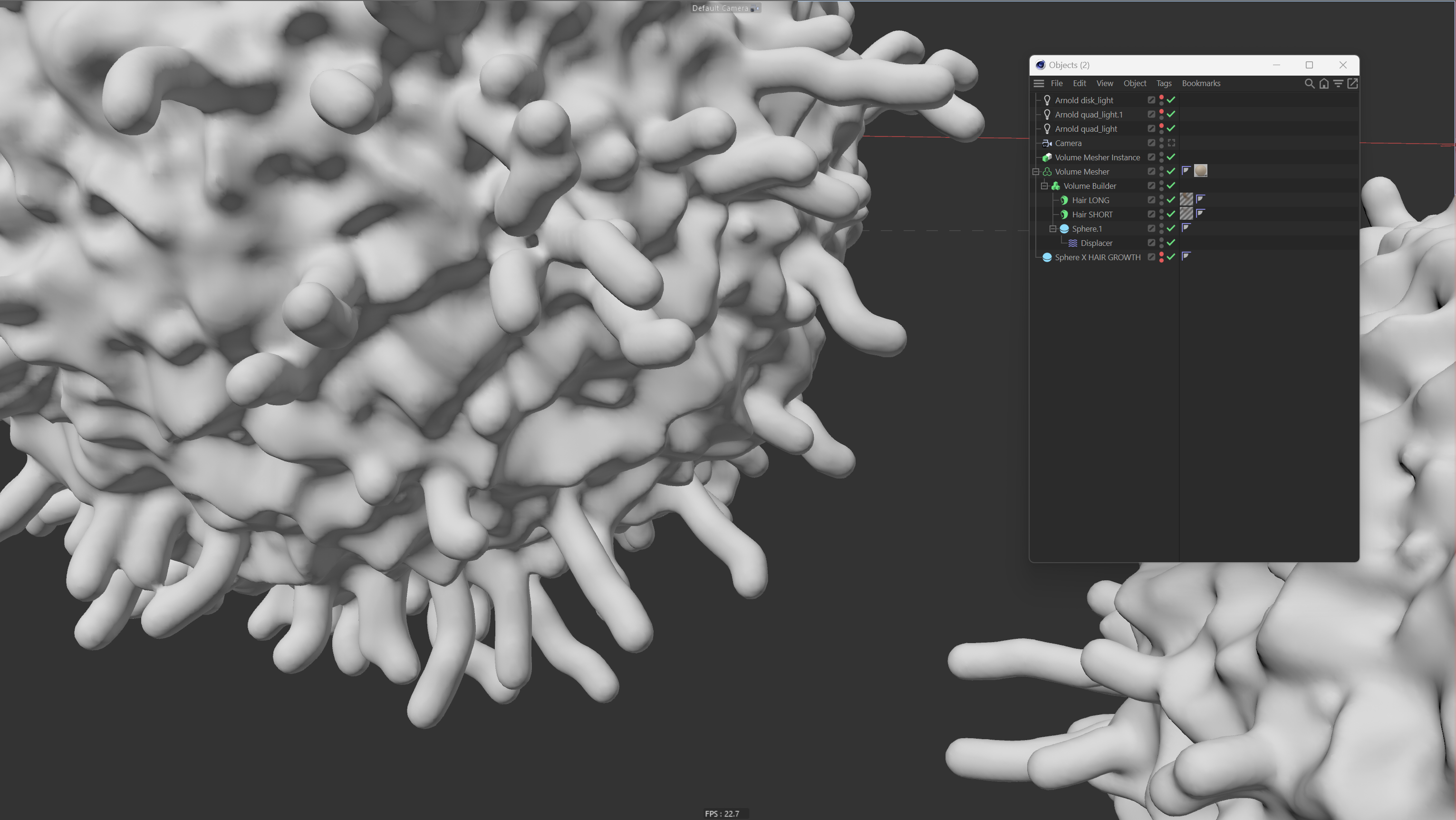

you can try playing with hairs and volume builder or, if you're using the latest version, the new particle system (emitting from a sphere and tracing the particles)

Hi Visualtricks
Thank you for the solution suggestions. The way it looks in your screenshot is getting very close. I'll have to take a closer look again at Hairs and the Volume Builder.
