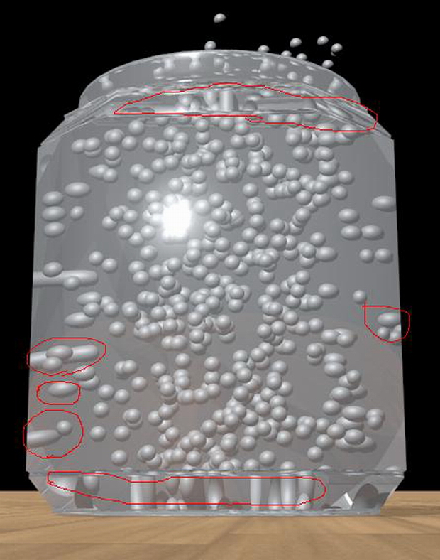

Need help! Glass material problem

Re: Need help! Glass material problem
Try to make the object with thickness and not with only one poly face..
You need also the internal volume, so if you modelled the external glass with thickness, try to make another object without thickness for the liquid and put it inside the object.
