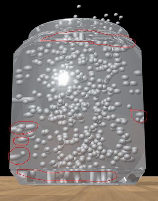

i gave a glass material to my object (i did try many other glass materials too)but every thing inside the object seems distorted and deformed by glass material,what i have to do??? please help!

Hi!, usually if you want a very good glass material effect you need to model the object with right thickness so the IOR on material trasparency channel give to it a right distorsion effect :)
Try to make the object with thickness and not with only one poly face..
You need also the internal volume, so if you modelled the external glass with thickness, try to make another object without thickness for the liquid and put it inside the object.
