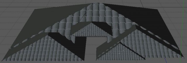

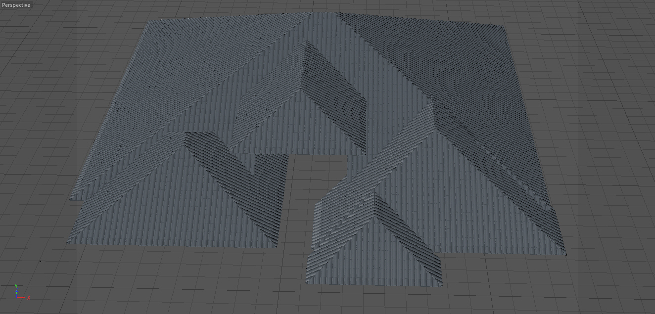

Help........I used the same settings for each roof surface, but the tiles on each surface are different scale-size [see attachment].
What am I doing wrong?

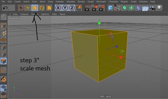

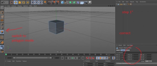

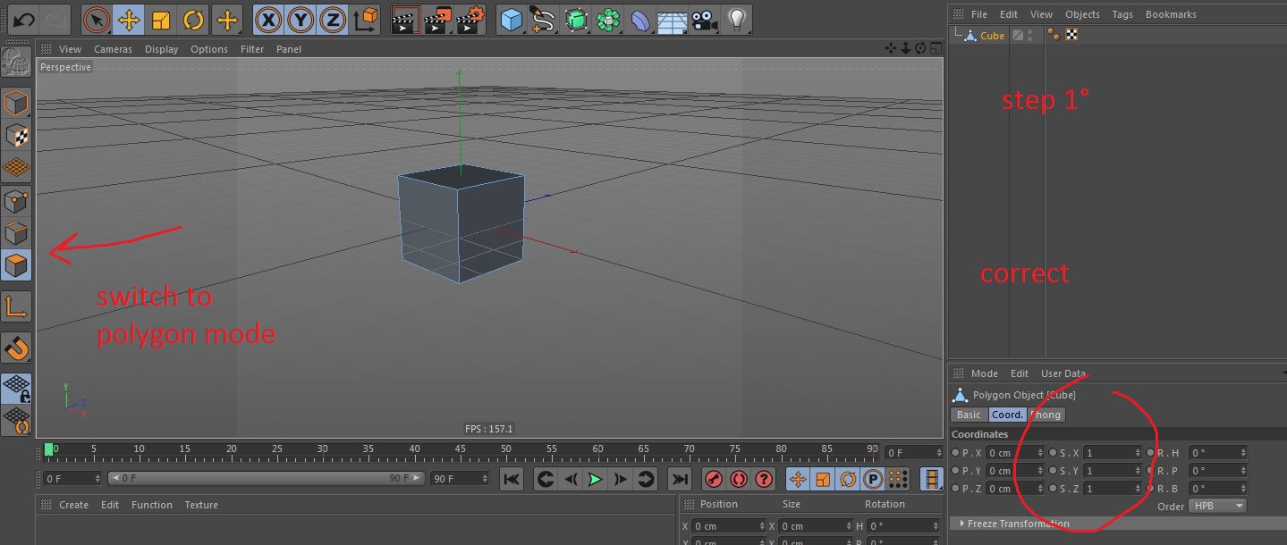

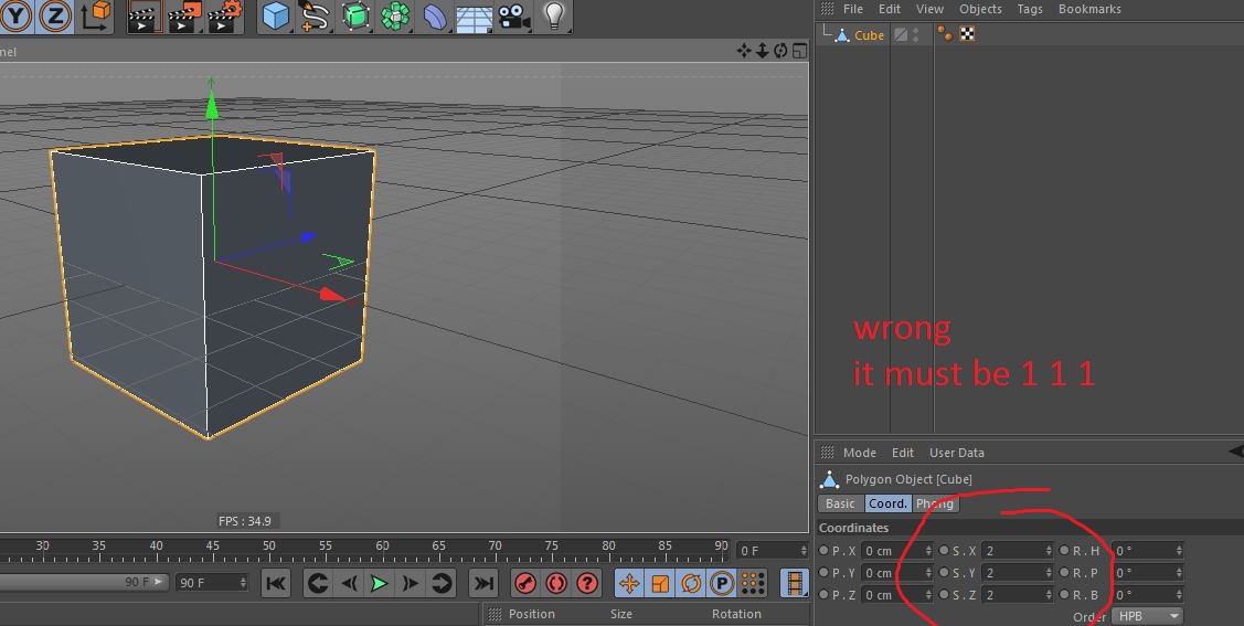

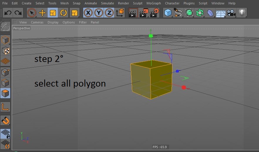

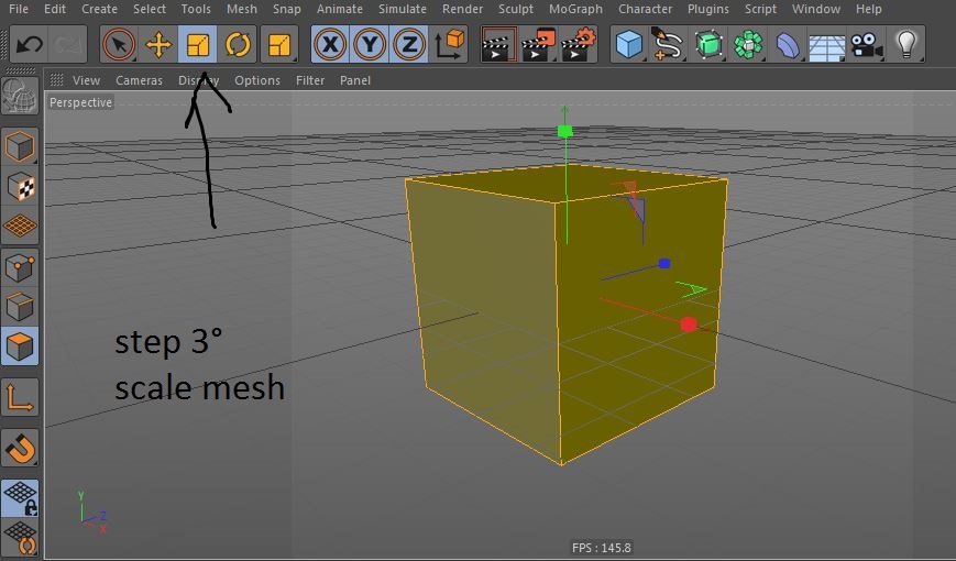

these are the steps to do in order to scale the mesh of your roof without using scale matrix

Here are the steps, if I understand right from the pictures:
[1] Set scale to 1:1:1
[2] Go into polygon mode. Select all polygons.
[3] Scale the mesh [while in polygon mode].

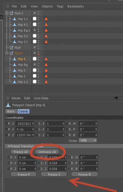

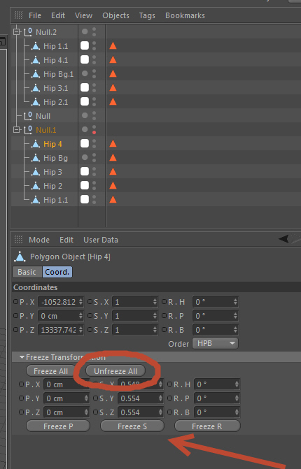

the problem is that you have freezed also the scale :o
did you import the model from a cad? because it's the first time I see a roof with Scale freezed, usually the freeze command is used only for animation not for modeling.

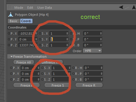

click unfreeze all button and set the roof scale and frozen scale to 1:1:1
than follow the steps I described before

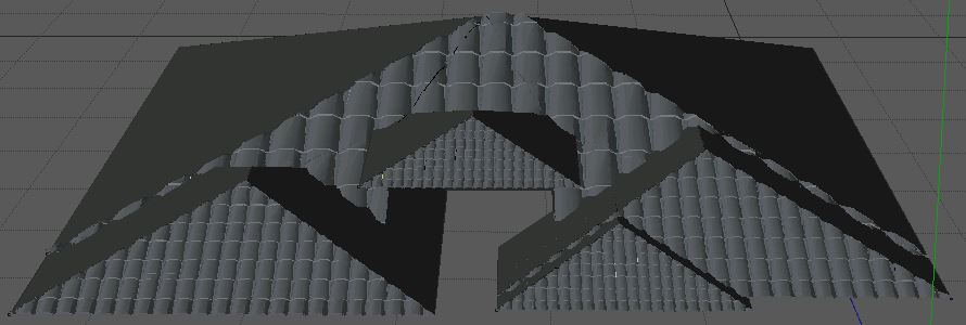

I repeat again, the problem is not on Cinema but within the model
see the attachment, there is your model correctly set to scale 1:1
you need to set each object to scale 1:1, remember that in Cinema an object inherits his scale from his parent and your null parent has got also scale different from 1:1
