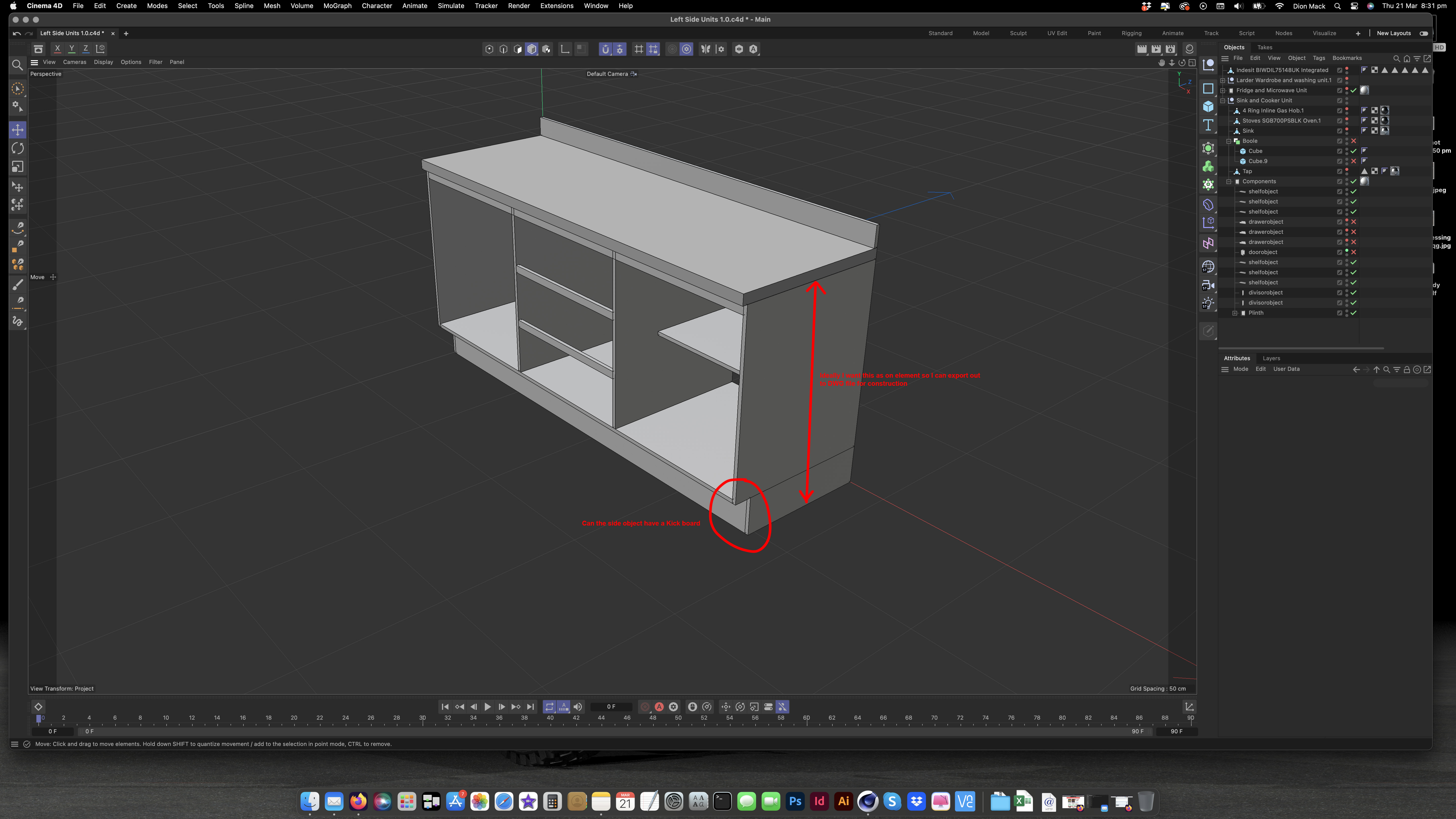

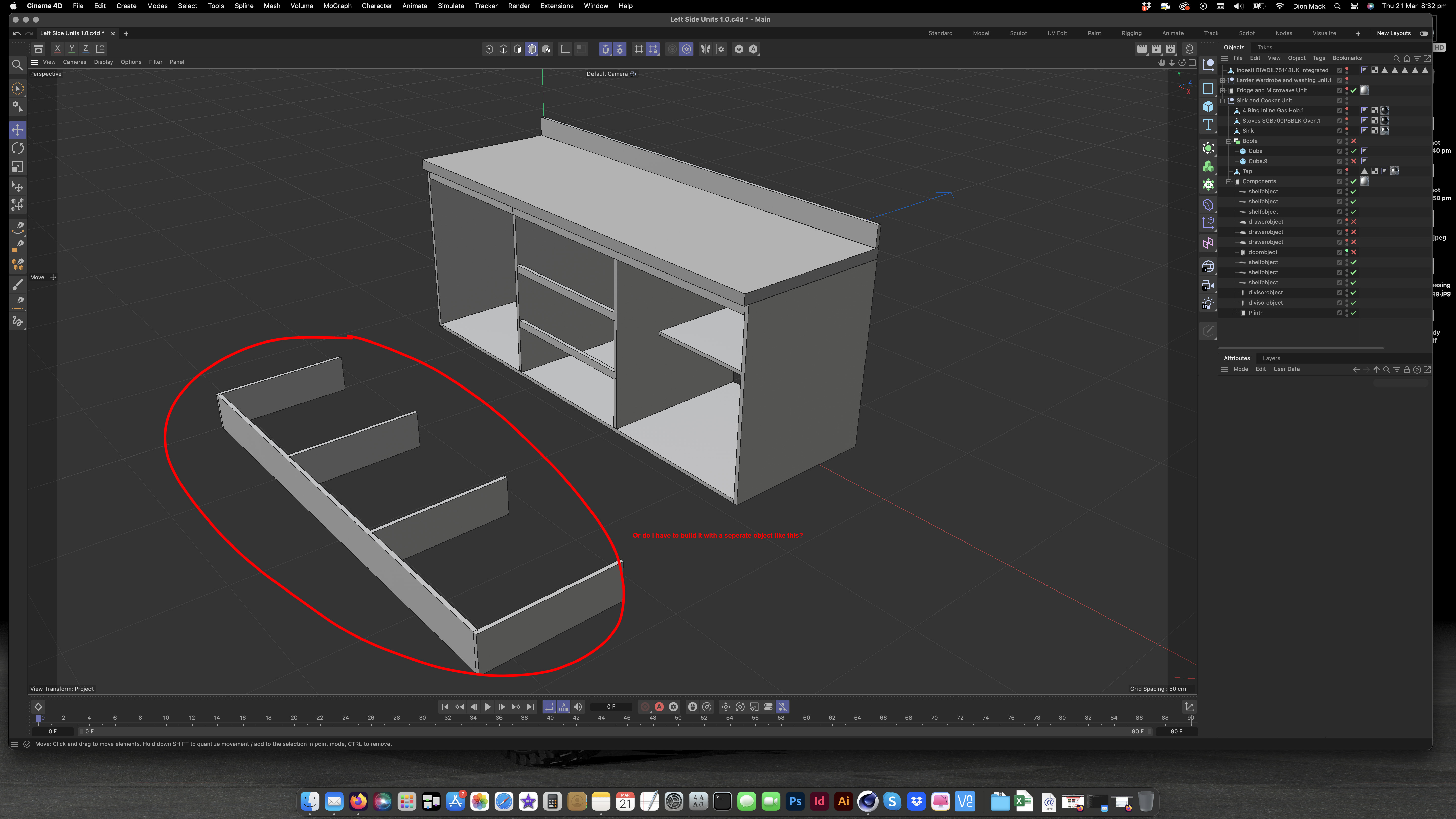

Hi Matteo,
I’m using your Interior Builder plugin for Cinema 4D.
I have couple of questions actually.
Is it possible to make the sides of the object have a kick board recessed as shown in my manually built model in the attached images?
Or do I have to build the unit as two elements as a base plinth and then the unit above?
Also is possible to add materials to individual elements?
It’s seems you can only add a material to the whole object not elements.
I would like to have different materials for the tops and sids etc.
Lastly is it possible to add a sink option into the top element?
Many thanks
Dion

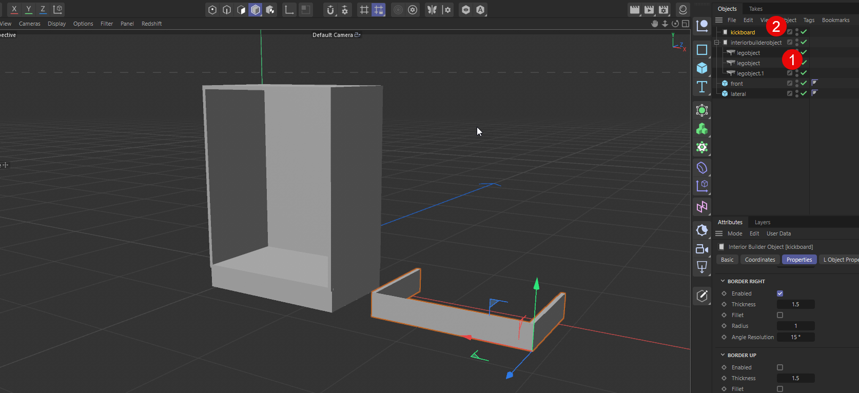

Hi you can do it in two ways
1) with custom leg objects (not so fast)
2) using an interior builder object without top and bottom border rotated by 180°
an attachment in the example
Best regards
Matteo
